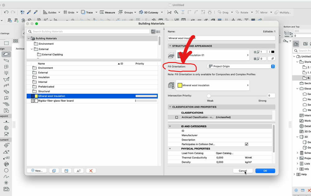

Hello guys! I need an assistance! Do you know if there is a way to change the fill orientation via the API? I'd be glad to receive your sollutions! Thank you!

Hi, I'd suggest you try to change the parameter of cutFillOrientation in following data with ACAPI_Attribute_Modify():
HTH.
 typedef struct {
        API_Attr_Head             head;
        GS::UniString             *id;
        GS::UniString             *manufacturer;
        GS::UniString             *description;
        Int32                     connPriority;
        API_AttributeIndex        cutFill;
        short                     cutFillPen;
        short                     cutFillBackgroundPen;
        API_AttributeIndex        cutMaterial;
        API_FillOrientationID     cutFillOrientation;
        Int32                     filler_0;
        double                    thermalConductivity;
        double                    density;
        double                    heatCapacity;
        double                    embodiedEnergy;
        double                    embodiedCarbon;
        bool                      showUncutLines;
        bool                      doNotParticipateInCollDet;
        bool                      filler_1[6];
    } API_BuildingMaterialType;
