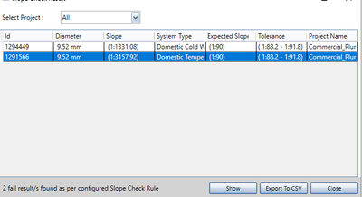

I want to create such an UI Where a table is displayed and the user is able to make selections by clicking on any row in the table.
