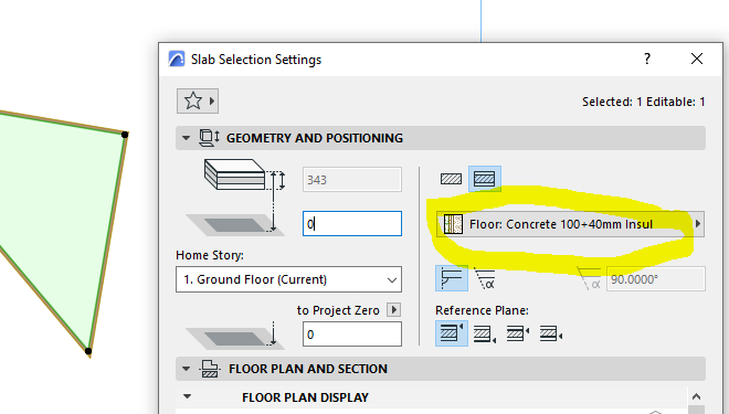

I would like to extract the composite name from walls, slabs, and roofs using the API. I have got all the other information I need (dimensions, instance name, etc) but I am struggling to find where to get composite info. I have attached 2 screenshots showing what I need to get.
Could someone point me to where this value is held?

The Composite is in element specific structs
here is a example of the wall:
https://archicadapi.graphisoft.com/documentation/api_walltype?s=API_WallType
you get the Attribute Index and with ACAPI_Attribute_Get you should be able to mangle to the name of the composite

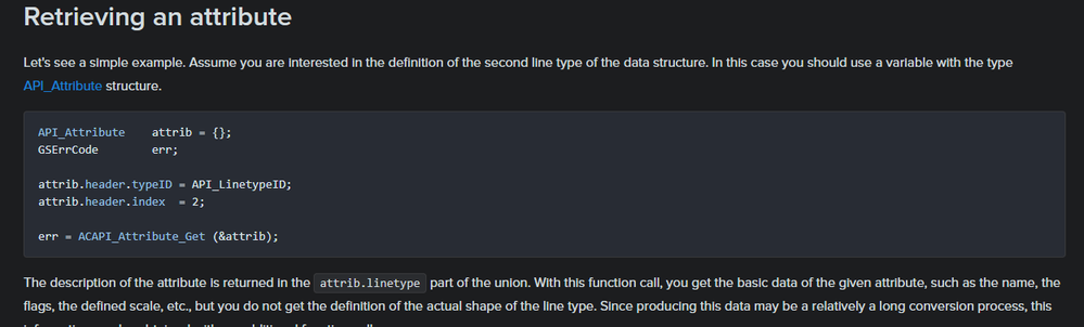

Hello @YourQS thank you for your response.
Pardon me for not adding comments to the line of code. NOTE: As I mentioned earlier I am new to using the Archicad C++ API.
The "attrib.header.index" specifies the index value of the attribute. I observed that in the Attribute Manager documentation (see the picture).
I wanted to extract the attributes of all the Building Materials within the Archicad Database (as is) therefore I thought iterating through the index was the best way.
I got results (e.g. Guid, name, connPriority, cutFill, cutFillBackgroung, etc) but I could not access the ID and manufacturer.
If you have a better suggestion and advice I await your response.
