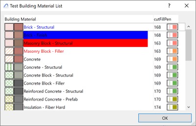

There are two examples in DG_Test example Add-On that can help you with this.
Example 1: DG_Test AddOn, BuildingMaterialDialog.cpp
It calls the SetTabFieldOwnerDrawFlag on a ListBox so the ListBoxTabFieldUpdate function will be called and you can draw whatever you want. Check the UpdateBuildingMatDrawTab and DrawBuildingMaterial function to see how to use actual pens and fills.
Example 2: DG_Test AddOn, UserItemDialog.cpp
This example uses a DG::UserItem that you can draw to. Check the UserItemUpdate function to see how it works. Combined with the previous example I think you can achieve your goal of drawing attribute previews to any dialogs.

Thanks, it seems to solve our issues around the topic.
