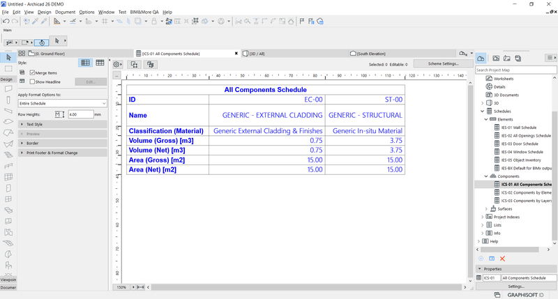

I have a generic wall with default parameters. When I open the All Components Schedule there is a list of all components of this wall. How can I get the area and the volume as displayed in the screenshot? Didn't find any sample code in the examples.

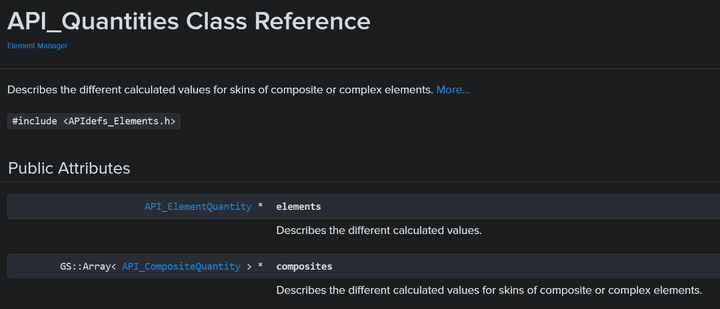

I think you can get these values via ACAPI_Element_GetQuantities.
The composites member of the API_Quantities object should have exactly those values you are looking for.

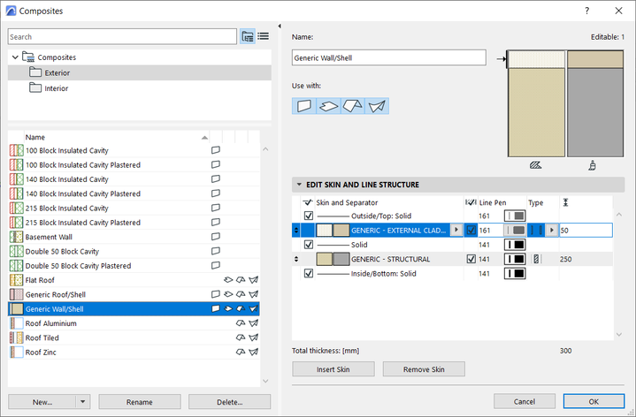

In the above example I have a composite wall with 2 skins

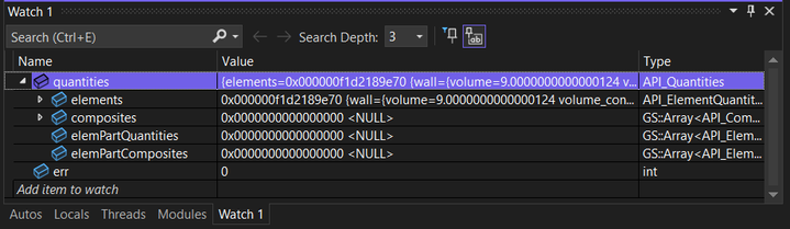

I was thinking about getting the quantities for the element wall and then checking quantities->composites.
Did you try this too?
Automating Archicad with Add-Ons, GDL-Objects & Python Archi-XT.com
It's NULL
Hm... you probably need to allocate the composites member first, like you did for the elements member.
API_Quantities quantities;
API_ElementQuantity quantity{};
quantities.elements = &quantity;
GS::Array<API_CompositeQuantity> compositeQuantities{};
quantities.composites = &compositeQuantities;
