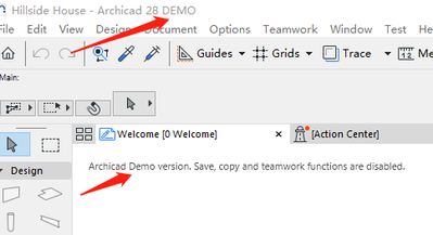

This API still has no effect, but the return value is NoError. Is it related to my ArchiCad currently running DEMO status?
When you say it has no effect, do you mean you don't see the view come to the front? If so, this isn't what ACAPI_Database_ChangeCurrentDatabase does. It makes the 3D window the current database for all following API commands that concern a specific database, e.g. ACAPI_View_Rebuild
If you simply want to bring the view to the front, use ACAPI_Window_ChangeWindow, but I don't think that's what you want to do in the context of a notification handler
