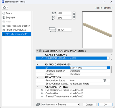

I want to put the ID value in C++ while creating Beam.
LeeJaeYoung
I want to put the id value in C++ while creating Beam.
What should I do?
I created it by looking at the create element_test code.
What can I study?
I'm a beginner who can understand if you give me the code. ^^

Is this what you need: ACAPI_Database(APIDb_ChangeElementInfoStringID, ...)?

LeeJaeYoung
GSErrCode ACAPI_Database(APIDb_ChangeElementInfoStringID,element.header.guid, "ABC111");
err = ACAPI_Element_Create(&element, &memo);
if (err != NoError) {
ACAPI_WriteReport("ACAPI_Element_Create (Beam) has failed with error code %ld!", true, err);
I'm a beginner so I don't understand because I don't have the code.
I need a code that can change the ID value.
1. I'm curious whether it's before or after creation and why the error occurs. ^^

Miha Nahtigal
You need to call your routines inside ACAPI_CallUndoableCommand()  block.

 err = ACAPI_CallUndoableCommand("Create Beam",
[&]() -> GSErrCode {
return ACAPI_Database(APIDb_ChangeElementInfoStringID, &element.header.guid, "xx");
The id value did not change to "XX".
return ACAPI_Element_Create(&element, &memo);
The following error occurs.

err = ACAPI_Database(APIDb_ChangeElementInfoStringID, &element.header.guid, &na);
ACAPI_Database not found in archicad 27 api
There is also no content in ACAPinc.h.
What should I study?
And I don't have apidevkit.chm, where should I search for it?
AC27 on window 11
Check migration documentation and ACAPI_MigrationHeader.hpp inside Support\Inc folder
Use  ACAPI_Element_ChangeElementInfoString() instead of ACAPI_Database(APIDb_ChangeElementInfoStringID...)
