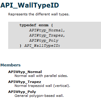

I would like to know how to create a wall using Wall Geometry Method:Polygonal.
LeeJaeYoung
I would like to know how to create a wall using Wall Geometry.
What sample code can I study?

Yes that's what you are looking for. You will have to use the polygon data in the memos.
Something like this:
GSErrCode CreatePolyWall ()
  API_Element element {};
  element.header.type = API_WallID;
  ACAPI_Element_GetDefaults (&element, nullptr);
  element.wall.type = APIWtyp_Poly;
  element.wall.modelElemStructureType = API_BasicStructure;
  element.wall.poly.nCoords = 5;
  element.wall.poly.nSubPolys = 1;
  element.wall.poly.nArcs = 0;
  API_ElementMemo memo{};
  memo.coords = reinterpret_cast<API_Coord**> (
    BMAllocateHandle (sizeof (API_Coord) * (element.wall.poly.nCoords + 1), ALLOCATE_CLEAR, 0));
  if (memo.coords == nullptr) { return APIERR_MEMFULL; }
  (*memo.coords)[0] = { 0.0, 0.0 }; // always has to be (0,0)
  (*memo.coords)[1] = { 0.0, 0.0 };
  (*memo.coords)[2] = { 1.0, 0.0 };
  (*memo.coords)[3] = { 1.0, 1.0 };
  (*memo.coords)[4] = { 0.0, 1.0 };
  (*memo.coords)[5] = (*memo.coords)[1];
  memo.pends = reinterpret_cast<Int32**> (
    BMAllocateHandle (sizeof (Int32) * (element.wall.poly.nSubPolys + 1), ALLOCATE_CLEAR, 0));
  if (memo.pends == nullptr) { return APIERR_MEMFULL; }
  (*memo.pends)[0] = 0;
  (*memo.pends)[1] = 5; //index of polygon closing coordinate/vertex
  memo.vertexIDs = reinterpret_cast<UInt32**> (
    BMAllocateHandle (sizeof (UInt32) * (element.wall.poly.nCoords + 1), ALLOCATE_CLEAR, 0));
  if (memo.vertexIDs == nullptr) { return APIERR_MEMFULL; }
  (*memo.vertexIDs)[0] = element.wall.poly.nCoords;
  for (Int32 vIdx = 1; vIdx <= element.wall.poly.nCoords; ++vIdx) {
    (*memo.vertexIDs)[vIdx] = vIdx;
  memo.edgeIDs = reinterpret_cast<UInt32**> (
  if (memo.edgeIDs == nullptr) { return APIERR_MEMFULL; }
  (*memo.edgeIDs)[0] = 0;
  for (Int32 eIdx = 1; eIdx <= element.wall.poly.nCoords; ++eIdx) {
    (*memo.edgeIDs)[eIdx] = eIdx;
  GSErrCode err = ACAPI_Element_Create (&element, &memo);
  ACAPI_DisposeElemMemoHdls (&memo);
  return err;

thank you.
This is the c++ api forum. ^^
I found Polygon in API_WallType. I think I'll probably use this.
I don't know if it's true.
It hasn't been tested yet.
