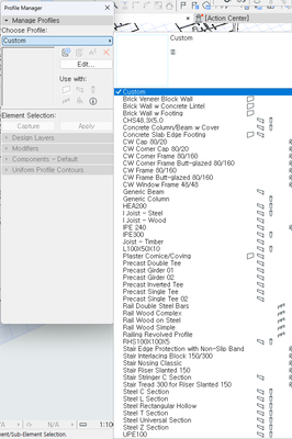

Is it possible to create a profile column wall with api c++?
If possible, which sample file should I study?
You told me that wall composite files are possible.
So, I'm curious about whether a wall column beam profile is possible, so I'm asking.
If possible, I would appreciate it if you could let me know what part I need to study.
AC27 on window 11
1 Solution
Viktor Kovacs
Ok, I see, you would like to create a Profile Attribute. It's a bit more tricky, please check the Attribute_Test example Add-On, and see the Do_CreateProfile function for an example.

.To create a profiled one, change these lines.
        element.wall.modelElemStructureType = API_ProfileStructure;
        element.wall.composite = profileIndex;

I've been asking to make a STYLE.
AC27 on window 11
Viktor Kovacs
