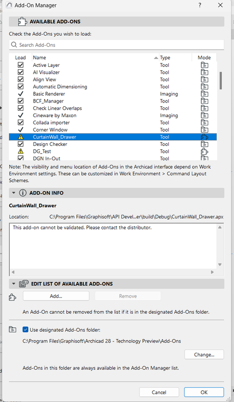

We have build 2 examples files in the SDK 28.200. Each time we add the generated files to Achicad, we got a message "This add-on cannot be validated" in the add-on manager.
Could you please confirm that if you build the apx via the cmake, it does work in the Archicad 28 technology preview.

Could you check whether you've generated your proper Developer/API Local ID and added in xxxFix.grc file?
HTH.

Could you load the 2 example .apxs with Archicad28 demo mode?
(run Archicad.exe -DEMO)
HTH.
The error still remains...
