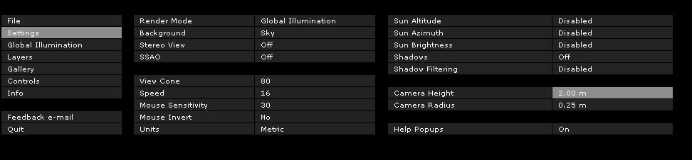

I know you can set it up on the desktop viewer/editor. I don't know if it 'sticks' to the iOS viewer afterwards.

I tried saving a couple of new BIMx models (with the correct height set in the desktop viewer) and they all revert to a diminutive stature on the iPad.

As mentioned above i know you can open a bimx on desktop and re-save it after adjusting the head height (or other parameters such as lighting etc), i know that this saved file displays correctly once opened again on a desktop
not sure about mobile devices

Height can be adjusted in the device settings.
bimx-application-settings-on-mobile-devices
Not perfect. Given a choice of:
- Lower
- Low
- Default
- High
- Higher
No way of knowing the elevation of these choices or how to set the default.

It seems the value of "Default" is hardcoded into BIMx application on iPad and is unrelated to the export camera height (even though you start at your camera height in flight mode, but you immediately drop down to "Default" as soon as you activate virtual joystick).
If we want to know exact values, we can, potentially, make a vertically graduated ruler object in AC, export it to BIMx and walk right to it on iPad. Changing the height setting in iPad Settings will show you what hardcoded "High" "Higher" "Low" "Lower" values are.
They come out to be 1,2m 1,4m 1,6m 1,8m and 2,0m respectively.
With 1,6m height being the "Default".
