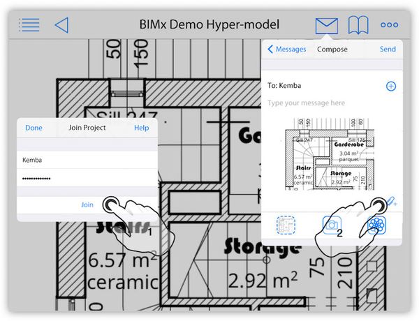

Join into the BIMcloud project to get BIMx Pro functions
After the BIMcloud project has been published to BIMx builders or other project stakeholders will see an option where they can join into the project as team members from their Android/iOS device.
  • The same username & password can be used as from Archicad.
  • Joining in with the same user in BIMx will not log you out from the Archicad project.
  • Using Archicad and BIMx with the same user account requires only one BCU (BIMcloud User license) from the BIMcloud
Send messages and photos from BIMx
After logging in, a mail icon appears at the top right corner in the 2D and 3D views. By tapping it the messages panel comes up where you can send text messages to other team members through BIMcloud's messaging interface. With using the attachment button you can include a 2D/3D view of the model or you can shoot a photo e.g. on the construction site that you want to directly send back to the Archicad team:
Archicad users will see these messages the same way as if an other Archicad team member would have sent them. If a 3D view of the model was attached to the message its view can be applied at the receiver's end; this helps specifying the area in the virtual model you would like to comment on and therefore it makes communication within the project clear, easy and fast for both parties. On the Teamwork messaging panel it's also visible whether somebody is joined into the project from mobile or from Archicad.
Mark up screen captures and camera images in the message
Attached 2D/3D views of the BIMx file and camera photos can also be marked up for better understanding. Use the free hand redlining tool to annotate these images:
