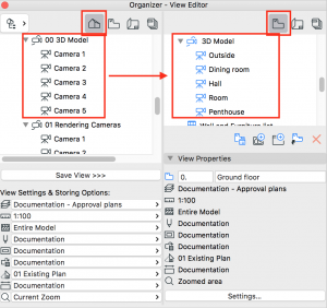

Did you know that you can predefine different navigation options for your BIMx model? By placing camera views into the Archicad project you can add movies to help your client explore the BIMx model. It is also possible to limit the navigation only to these videos/camera views. This article will guide you through this process step-by-step.
Choose the Camera Tool from the Toolbox and place cameras on the Floor Plan view to the points from where you would like to show your building in 3D. The first click defines the position of the camera and the second click sets the direction where the camera looks. You can tweak the view settings further by changing the parameters in the Camera Tool's Settings dialog.
By placing the second Camera, Archicad automatically defines a camera path for you connecting the placed cameras. This path can be continued with adding further cameras.
Once you are finished with your camera path you can define a new path (or new separate camera view) by clicking the New button on the Camera Settings palette.
To save the Camera path as a view simply drag & drop it in the Organizer from the left to the right between the Project Map and the View Map.
Place the Camera path, or multiple Camera paths into your BIMx publisher set simply by dragging and dropping them in the Organizer from the View Map on the left to the selected Publisher Set on the right:

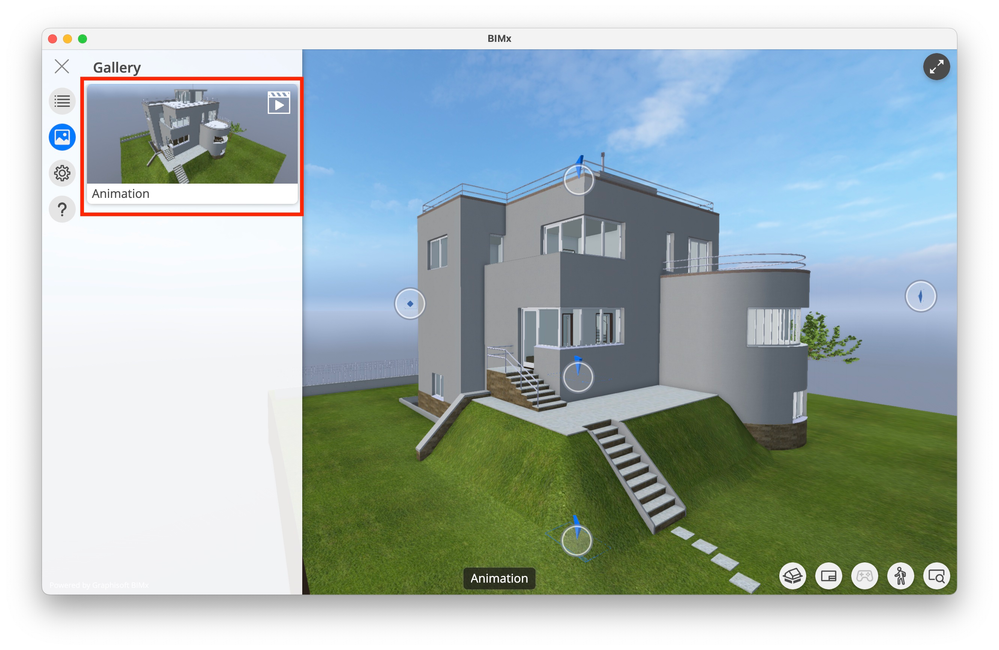

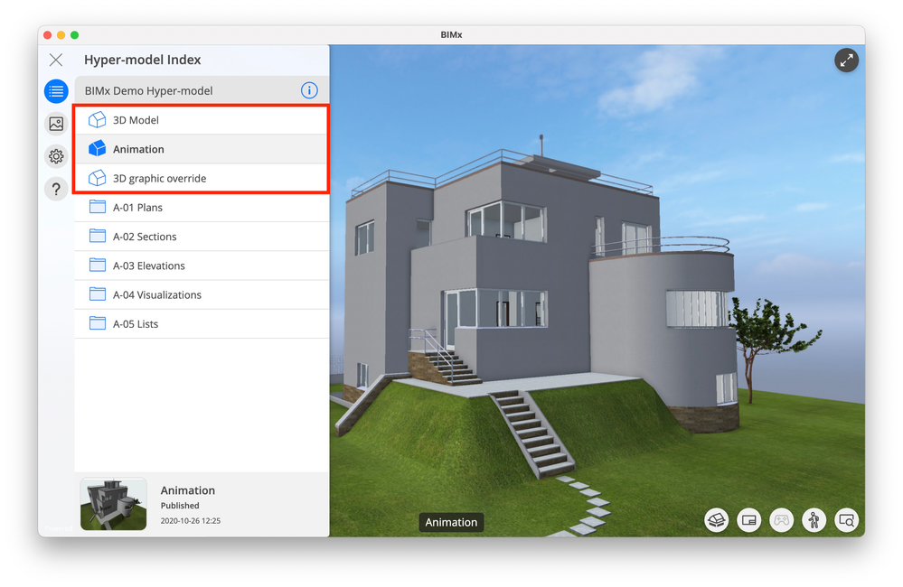

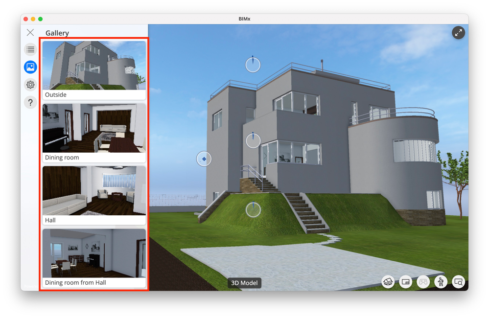

When selecting a Camera path in the publisher set you can control its settings by clicking on the Options… button:
In the BIMx Export Options / Gallery options there are two possibilities to choose from:
