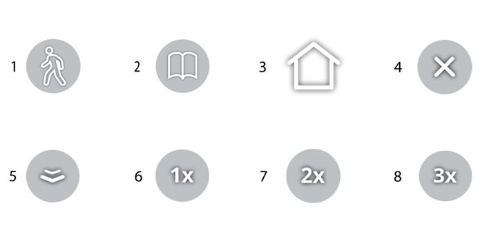

Interface Elements
The VR mode proposes several icons that will help you navigate through your building in a smooth way.
  1. Walking mode
  2. Bookmarks (Favorites + Gallery)
  3. Home
  4. Exit
  5. Step back
  6. Slow walk
  7. Fast walk
  8. Very fast walk

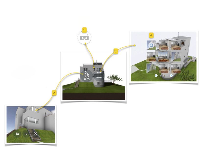

Workflow
Start
Press the Cardboard icon in the "..." more options menu to open VR mode while in a BIMx 3D view.
Calibration
Find the Settings wheel on the lower center part of the screen. Scan the QR code of the cardboard you are going to use. This will pair and calibrate the cardboard device with BIMx (the QR code is located on the cardboard box).
Cursor usage
Rotate your head to move the blue 3D cursor. It gets bigger (double size) when placed on an item or a menu, at the same time the item or menu will also get bigger, to emphasize that it has been selected.
Access the main menu
  • Access the VR mode by pressing the cardboard icon (while in a BIMx 3D view)
  • Press the physical button on the top of the cardboard to open the menu interface
  • Place the 3D cursor on the desired mode (two options):
    • Walking mode
    • Bookmark (Favorites and Gallery items)
  • Press the physical button on the cardboard to validate the selection
  • This will activate the desired command
Walking mode
  • Select the walking mode icon
    • You will now start navigating within your model
  • Press the physical button to stop walking
  • You are then offered 3 options
    • Walking speed - You can choose from 3 speeds to walk in your model
    • Step back - 2 steps (~1 meter)
    • Exit walking mode
  • If you do not select any of these 3 options with the 3D cursor, you can go on with walking (by pressing the 3D cursor anywhere else than the 3 options)
  • Pressing the Exit walking mode button will send you back to the main menu
Bookmark menu
  • Select the Bookmark icon
    • You will now see all your Favorites and Gallery items
  • Press the physical button to select an item - The upper left item (Menu icon) will send you back to the "Home" camera view of your model
    • To exit the Bookmark page and go back to your on-going camera view, press the 3D cursor anywhere outside the Bookmark window
  • BIMx then teleports you to the 3D location of the item you selected
