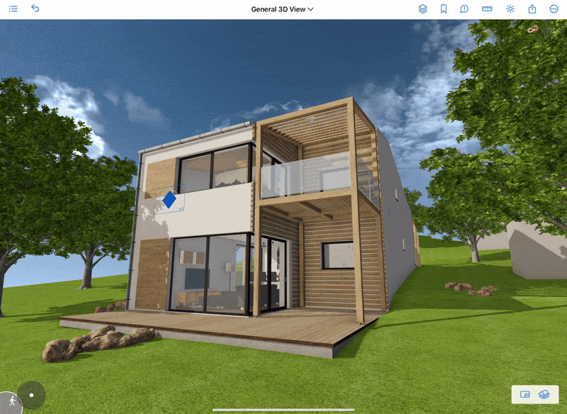

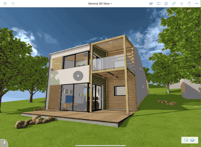

BIMx automatically switches between Rotate and Orbit navigation modes when you pass through the 3D model’s bounding box. Inside the Rotate navigation mode is active, while Orbit is active outside. This is called Adaptive rotation:

Walk Around

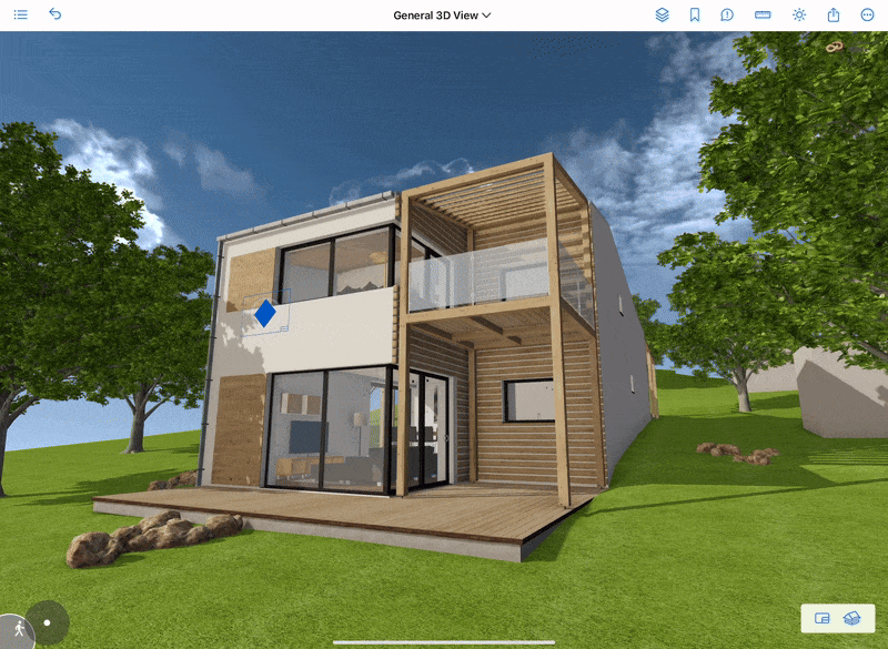

You can activate the joystick in perspective from the lower left corner to enable walk mode. It turns on gravity with collision detection, so you can walk through doors but not walls or other elements.
The default walk mode in BIMx Mobile is two-handed, recommended in landscape device orientation.
  • Move the joystick in any direction to move. Adjust speed by distance from the centre of the joystick.
  • Drag with your other hand to rotate the camera. Of course, you can move and rotate simultaneously.

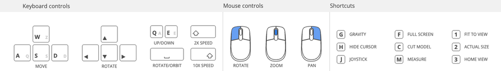

Keyboard and mouse
You can use your keyboard and mouse to control BIMx not only on the web and desktop but also on mobile. Connect these input devices and explore or present the 3D model without needing to touch your screen.

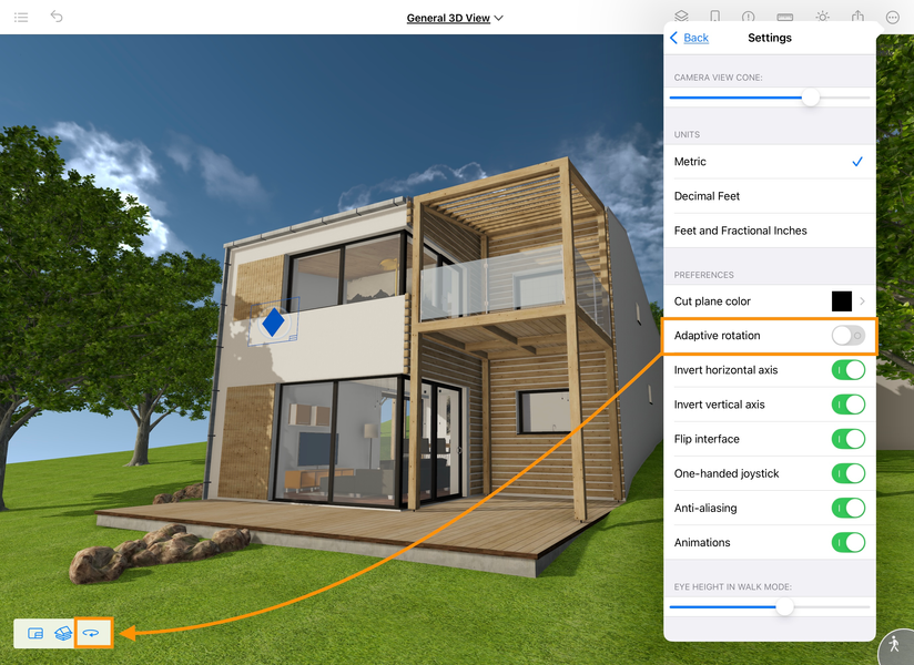

Adaptive Rotation
To deactivate the automatic switch between Rotate and Orbit navigation modes, turn off the Adaptive rotation toggle.
It reveals the manual Orbit button at the bottom of the screen on mobile, and in the Navigation quick-menu on web and desktop.
  • Active: Orbit navigation is enabled regardless of the camera position.
  • Inactive: Rotate navigation is enabled.

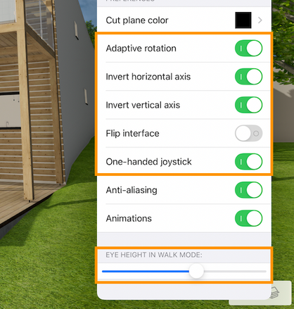

Invert Horizontal and Vertical Axis
These toggles control camera rotation direction in Rotate mode. By default, the invert axis toggles are on. This means that as you move your finger or cursor, the camera rotates in the opposite direction.
If you turn the toggles off, the camera moves in the same direction as your input.
Flip Interface
By default, the joystick is on the left side, and the function buttons (Cut model, Open 2D) are on the right. Use the toggle to mirror the interface. This feature is mobile only.
One-handed Walk Mode
By default off, which means two-handed Walk mode: move the camera with the joystick (forward, backward and sideways) and rotate with your other hand anywhere on the screen. Enable the One-handed joystick toggle to also rotate the camera with the joystick – recommended on portrait smartphones. This feature is mobile only.
Eye height in Walk mode
Use this slider to adjust the camera height in walk mode from 1,00m to 1,99m (from 3,28ft to 6,53ft).
