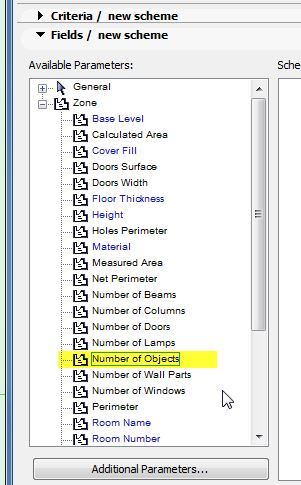

OK, I have another question:
Is it possible to have the Zone Schedule list the objects that are placed inside a zone?
Mac OSX 13.6.6 | AC 27 INT 5003 FULL

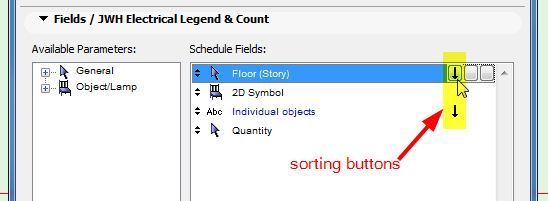

Achille Pavlidis
Another one:
Is it possible to sort the data according to a scpecific column, or do I have to export to excel and then re-import?
Achille wrote:
Another one:
Yes - these buttons are what you are after.
Achille wrote:
Nobody???
Looks like you can get the number of objects but not the names.
