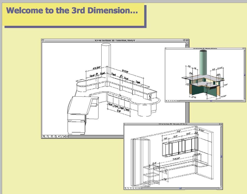

3rd dimension tool - objexonlyne
Is objexonlyne a web site? How much is this addon?
