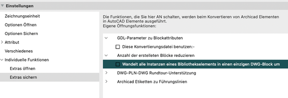

Sounds a bit like you accidentally turned on the option to merge all instances into a single block.
You find this in the translator under "Custom Functions" > "Save Extras".
Sorry for german screenshot:

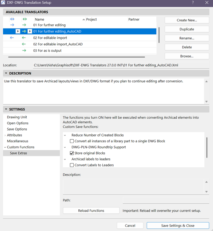

Thanks for the reply @runxel, I don't have it turned on in my settings. I've also fiddled with all the settings in the translator and tried with and without, unfortunately none of them seem to make a difference where block distortion is involved. I've attached my current settings below.
