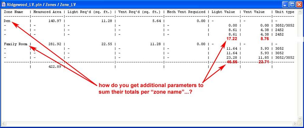

I'm giving up on the Interactive Schedule approach for now and am looking at developing a Zone List. I've found that I can create the Zone List with additional parameters from more than one element type...that's good! I've also found that I can use the Marquee to filter out the model area the way I want to with no problem...that's good!
Unfortunately I haven't figured out how to get my Light and Vent parameters to sum within each of the Zone Name areas...that's not good
please see the attached image...any comments would be appreciated
