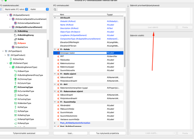

New legislation for applying building permit electronically mandates the use of certain custom property sets and properties in the ifc file to be submitted to the authorities. They include stuff like Site Address, Contact details, etc. The properties are mostly required in the IfcBuilding entity level, plus a few in the IfcSite. Looking into it, I was able to add them in the IFC Property Mapping dialogue, but can't assign any mapping rules to them, which means they would have to be input manually, although all of the required information is available in the model (Project Info, AC Properties, etc.)  Am I missing something, or is this really the case? Screen shot below.
Using AC25.4013 FIN on Mac.

Yes, this is the case. I would say it is probably because IfcSite and IfcBuilding are entities that have no equivalent element type in Archicad and Property Mapping is always based on elements in Archicad - you map the Parameter or Property of an element in Archicad to an IFC Property in the resulting IFC file.

But that is the only mapping that is being done on the IfcSite and IfcBuilding level and it is hard-coded into Archicad. So yes, you will have to input those values manually, and besides that the only thing you can do at this point is to make a wish for this functionality, so we can submit it to Graphisoft for consideration.
