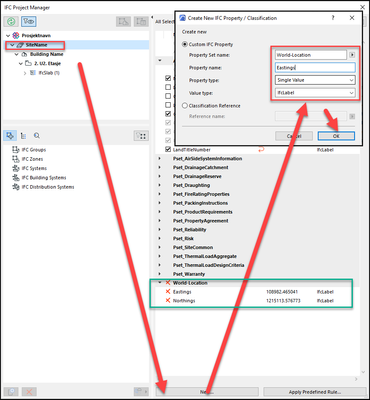

As I later discovered, you can actually do that, but not the way we are used to.
Here is what you do (and I have actually tested it, but I can't see any reason it won't work):
In Archicad, om the IFC-Project Manager,.and open the Site-folder:
Basically, do like you are mapping a P_Set for IFC-export: Press New, and the first time you do, you enter both P_SetName and Eastings (Or whatever you prefer). The next time you hit NEW, you make sure the P_set is the same, and enter Northings. Theese two properties have to be fed directly in the IFC-manager, like I just did in the picture.
The, close the manager, and export. No need for any work on the IFC-exporter. It is already done, since the P_Set is made in the IFC Project manager.

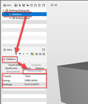

I eportet a little test-project to Solibri, and the result looks promising:
Of course, if your particular server requires a certain syntax, you just name the different elements accordingly.
