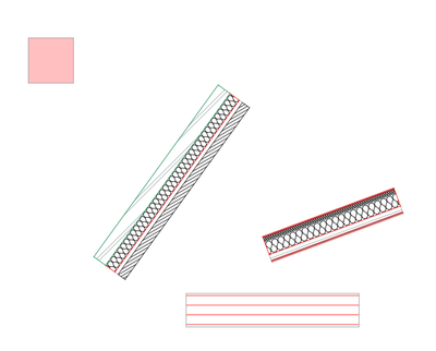

But I am encountering problems implementing this though. When setting up translation table, this works fine UNLESS the option for solid background fills is also set. Then we just get a solid background fill in DWG-programs like Autocad or Rhino.
Very strange is that, when importing the DWG back into Archicad 27 (on a Worksheet for example), both hatches are present... (although scale and orientation are mixed up)
Would this be a bug?
Images:
Floor plan view in Archicad: Archicad floor planArchicad floor plan
DWG result (exported WITH background to solids): DWG result - background fills not exported as solid fills using translation tableDWG result - background fills not exported as solid fills using translation table
DWG result (exported WITHOUT background fills): DWG result - background fills not exported, using translation tableDWG result - background fills not exported, using translation table
DWG result (WITH background fills!), imported to Archicad worksheet: Archicad dwg import to worksheet.png
