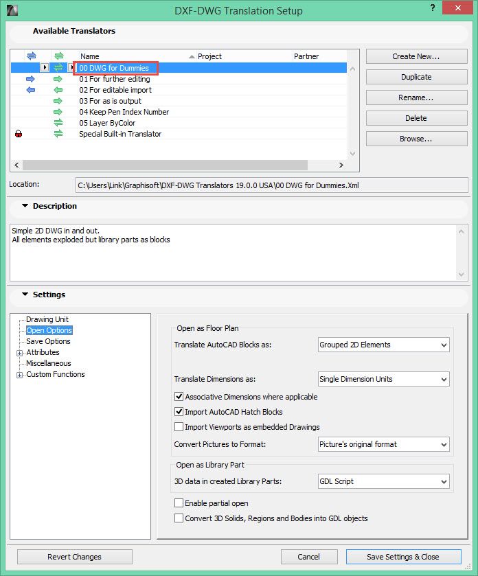

The US version actually has a translator called DWG for Dummies
Cheers,
Link.
David Collins
The INT version leaves that one out.
I don't know whether to feel insulted or complimented, but it sounds like exactly what we need.

Eduardo Rolon
here you go
