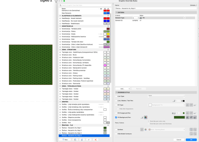

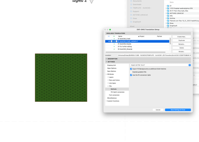

StefanV_BCP
Here are the screenshots of my settings.
Stefan Veselinović

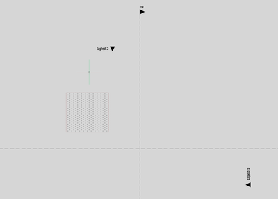

StefanV_BCP
While when setting inside fill i got the background coloure
