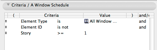

The story filter does work, however if story of the window/door seems to be determined by the setting of the sill or header value and the Anchor setting (e.g., "Header to Wall base", "Sill to Wall base", etc.)
I set the anchor to the sill, which was fully in my lower level (no overlap with story above) and the elements were ignored as desired with the criteria shown below. (The blank ID is to ignore empty openings.)
Your method of using a specify ID or lib part name of course also works.
