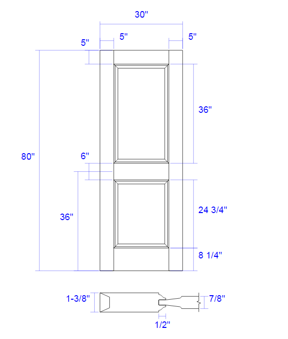

You could add Preview Picture to your schedules instead of View. The reason to do that is because you can make any kind of Preview Picture you want for the door panel. That might work if you don't need to add dimensions in your schedules.
Also, if you don't have too many doors you could edit the image in the Annotations window. Cover the casing with a fill ?
I get a lot of my door panel drawings from TruStyle. There is a CD they send out with hundreds of good drawings. I use them to make custom panels.
http://www.trustile.com/
Steve Jepson
Here is an example of the Annotation you could do to your door schedule.
This is done in the TruCAD online door panel maker, saved and used in the ArchiCAD Annotation window.
http://trucad.trustile.com/doordesigntool/
Lots of ways to get what you need with ArchiCAD door schedules.
