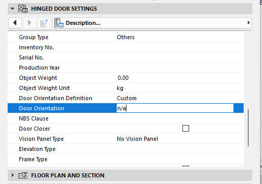

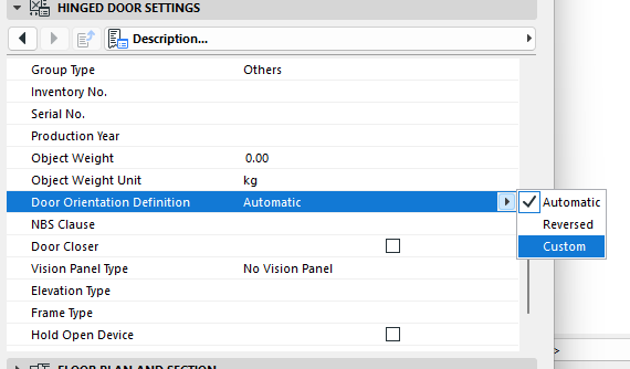

Solution
RoxanaG
I know I'm a bit late to the party, but there's an easier way to do it. Select your double doors and go to their settings. At the end, under Description, you'll find Door Orientation Definition, which is essentially giving you the orientation parameter from the GDL. Set it to Custom, and the orientation parameter becomes editable. You can leave it blank, write "n/a", or enter anything else you prefer. That is what will appear in your Schedule.
