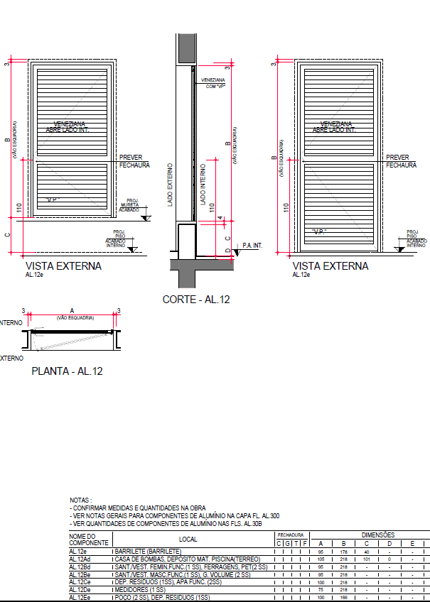

Can you post screenshot of the desired outcome in the cases of the various types of doors you mentioned? That way it may be easier to answer your question.
Hi Lazlo! Thank you for answering here.

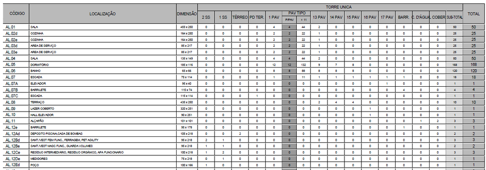

I need to do this kind of scheme (attached here). The doors which have an "d" (direita/right) or "e" (esquerda/left) in the name are the doors with 1 leaf only. There's an example of a door detailing with an opening leaf ("Exemplo Tabela 1").
The doors which have 2 leafs and central opening don't need the "d" (direita/right) or "e" (esquerda/left) opening indication.
As the scheme "Exemplo Tabela", I need to account separately doors that open to the right and doors that open to the left. Doors with central opening doesn't need this division between opening to the right or to the left. And I also need to account the doors and windows by floor in columns, specially the reference floor plan and show how many times it replicates in the project.
I think it's possible to understand better seeing these images I've uploaded.
Thanks again!!

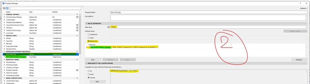

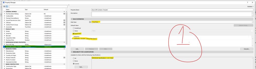

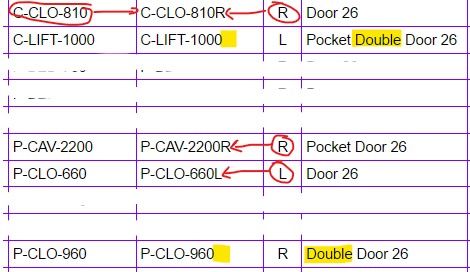

It works! See the snips for the expression code
As far as I know, the AC single doors don't allow for double doors. Unless there's a specific example of it not working, we might have a fool proof solution here.
Now the question for me is how to get my newly created property expression 'Door Info Tag' into the GDL of the door's dimension marker (eliminating some amount of manual input).  The relevant lines of gs_DW_Marker have been located if the idea is even possible.
