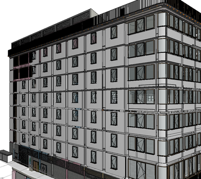

We are experiencing an issue with doors and windows not exporting from Archicad to IFC.
As shown in the snippets, windows are missing randomly. All windows share the same settings, classifications, etc.
This issue is occurring across several projects in the practice. The IFC files are relatively large (400–500 MB).
I have reviewed the IFCs in Solibri and Revizto, and the same elements are missing in both, which suggests the issue originates from the Archicad export.
Exported IFC in Solibri:

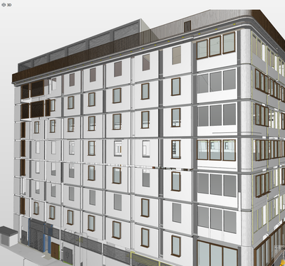

Model in Archicad 29:

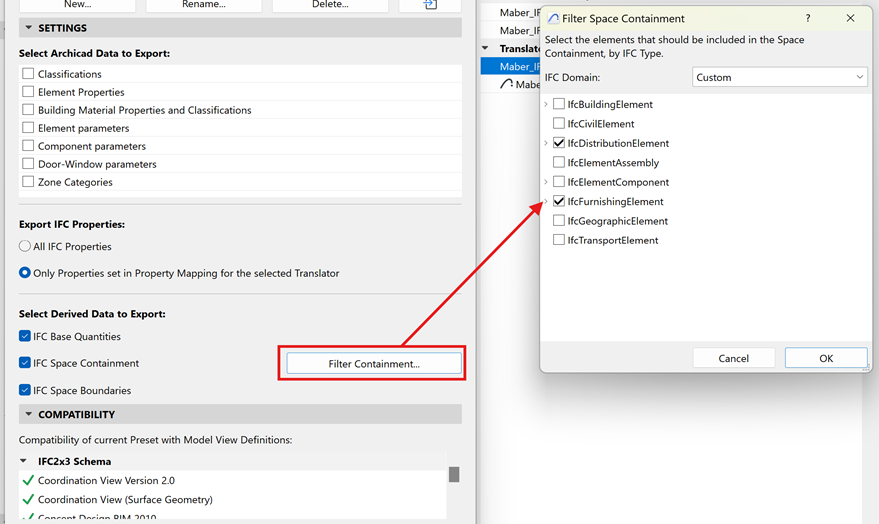

Hey, I’ve noticed that when the IFC Space Containment option is enabled in the Data Conversion settings of the IFC exporter, some windows and doors don’t always get exported.
In my case, unchecking that option fixed the issue, and I haven’t really looked into other possible workarounds.
Might be something to do with how the windows and doors are linked to zones.

Piotr Walerysiak
In the meantime I spoke to GS support and received the same advice.
However that setting is not compatible with FM Handover and COBie MVD.
So for my case, where COBie deliverable is required, this data conversion setting is suggested:
Thank you All, I learned something today

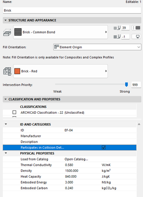

CosminF
Do you receive an error when exporting from Archicad? Usually it says that some elements couldn't be exported because the building material has this Participates in Collision Detection checkbox unchecked:
You might want to look here, this checkbox can also be used as a way to only export doors and windows.
