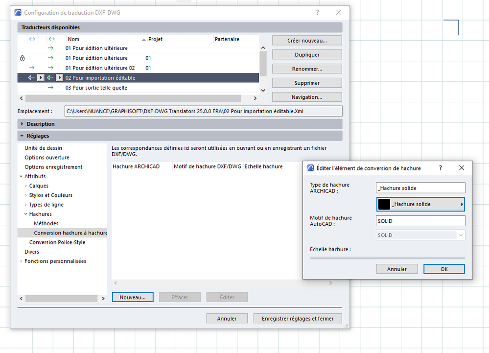

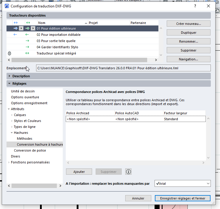

The DWG fill translator window shows the police translation parameters in AC 26 , checked AC 25 and it was OK,
is that a bug ??

Yes, it seems like when you activate the "Fill-hatch conversion" page of the Dialog, it displays the contents of the "Font conversion" page.
It may be a bug specific to the French localization because it works fine in my Ac26 INT version.
I will report this to Graphisoft.
