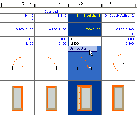

How to remove colour of preview picture in schedule list?
adura
How to remove window/door colour of preview picture in schedule list? Is it possible display clear window & door picture?

adura
I have changed "Model View Options" to "04 Ceiling Plans" and done! 🙂

Yes, but it is also beneficial to understand why it worked.
In the Override Fill Display panel of the Model View Options Dialog, if you check the Override Fill Background Color checkbox, or if you check the Override Cover Fills checkbox and choose the No Fill radio button, it will affect the display of those Views of Doors/Windows in Schedules.
The reason applying the "04 Ceiling Plans" MVO worked is because both of these checkboxes are checked in that MVO, while not checked in the other default MVOs.
