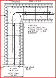

We have started using Nudura walls basically in every home now. http://nudura.com/EN/NuduraHome.aspx
The question I have is... Once I create the composite for the foundation wall with foam being on both sides... How do I only get the volume of the concrete without the foam in a schedule list? I hope it's something easy I'm missing.

It is possible to list Components with the Interactive Schedule.
I think that will do it for you.
Components of both Composite and Complex Structures can be scheduled.

I finally got to go back and work on this today... Once I set my core and finish everything worked out great!
Thanks for the info!
