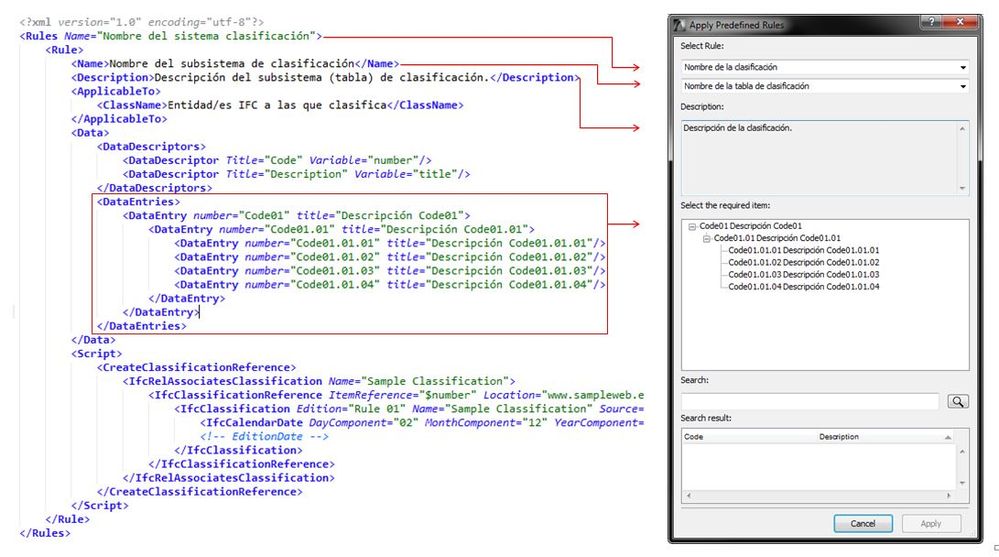

Hello,
I would wanna ask if the new (AC21) Classification Manager allows to synchronize its data with "Classification Reference" field of the Standard IFC Scheme, which we are using usually applying Predefined Rules or editing XML classification files. (i.e. Uniclass 2015, OmniClass or others).
This link is the new "Classification Manager" on AC21 --> https://www.youtube.com/watch?v=mVjY4UoG7Sw
Custom Element Classification is useful if it matches or synchronizes with Classification Rules, most of them National or International Standards to apply into "Classification Reference" STANDARD FIELD (not custom).
Thanks in advance

The default Classification in AC21 is just the main functional classification, regardless of any national or IFC classification with a main tree (Construction Element > Beam, Colum, Slab, Wall...).
You can still apply "Predefined Rules" as before and those arrive into the IfcClassification Reference property set.
You could also set up a new classification according to any national standard, if you wish.
The IFC Property Mapping is still available but now as part of the Translators.
You could then map your own Classification into the necessary IFC Properties via the mapping.

Meanwhile, we must keep editing XML if our goal is to implement a new or non-listed National or Official Classification System in the Predefined Rules.

In this BIM task group of Catalonia (GuBIMCat) , which I am on its board and also member, we wrote a post (as far in Catalan and Spanish) how to implement classification in models, and also how to create your own XML files with other classification systems.
--> http://gubimcat.blogspot.com.es/2016/12/como-gestionar-la-clasificacion-de-un_9.html

I've created one myself, starting from an Excel table and some formulas to put them into an XML structure as expected by the classification XML import/export.
In about 3 hours, I've prepared an XML, merged in my Excel text and did the reparenting back in the Classification dialog. This was for a local classification for social residential projects, widely used by Architect in Belgium. Alas, the majority of this system relates to materials and not elements, so usability is limited for ARCHICAD 21 (which only allows Zones and Elements, not Building Materials or Surfaces to be classified).
