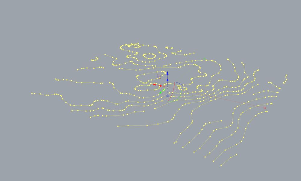

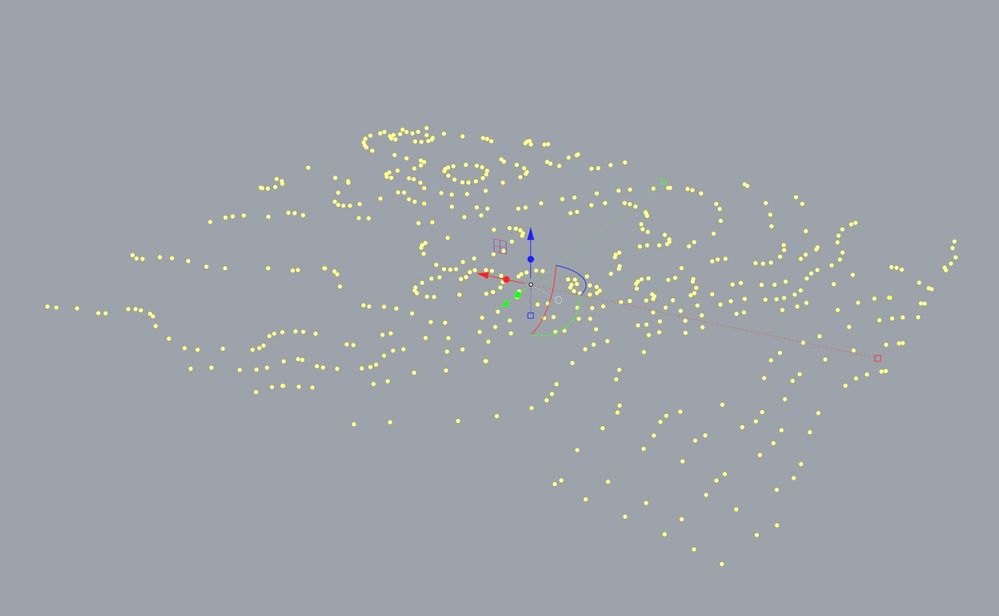

1. I got 3D Lines / curve - > I opened in Rhino and exported from lines to points and save like . txt = XYZ

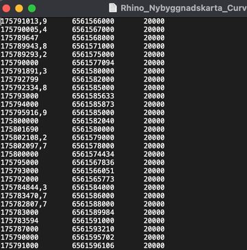

2. I opened in "notepad" and remove all symbols what I don't need it

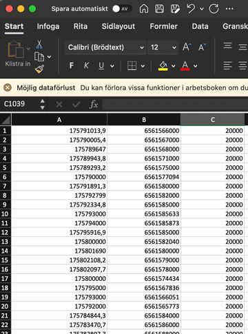

3. Then I opened in Excel and export to the 3 columns

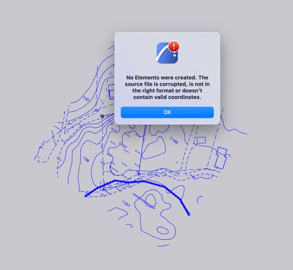

After all my work with it ... I stile cannot export it to Archicad šŸ˜•
I got Error note
What's wrong I'm doing ? It's becoming quite complicated but I really would like to learn it how to do it.
*No Elements were created. The source file is corrupted, is not in the right format or doesn't contain valid coordinates.

what kind of separator (tabulation, semicolon, comma... ) did you use?
when you open the xyz file with textedit?

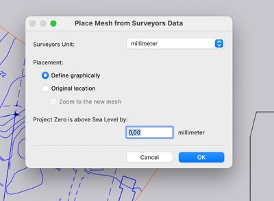

Thanks this is it ... I exported in meter but My export was in millimeters.
I fixed it just change meter to millimeters
Skärmavbild 2022-11-08 kl. 11.38.37.jpgSkärmavbild 2022-11-08 kl. 11.38.19.jpg
