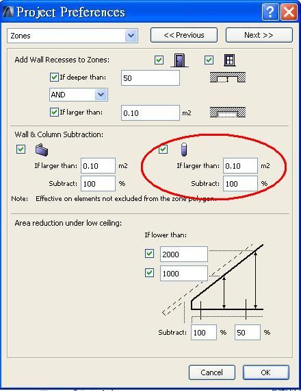

Incorrect calculated area of Zone Schedule
I set the Zone deduction(Figure 01), column relatoinship with zone(Figure 02) already. As you could see the Figure 03, the area difference would be around 2 sq.m. It's obvious the calculated area of Shop G(Figure 04). However other areas is correct. Any Comments?

Works correctly for me in AC14.
When you placed the Columns or made any change to the Zone, did you use the Update Zone command. Those values will be correct only after the Zones are updated.
Thank you! The update rectify the incorrect area calculation!
