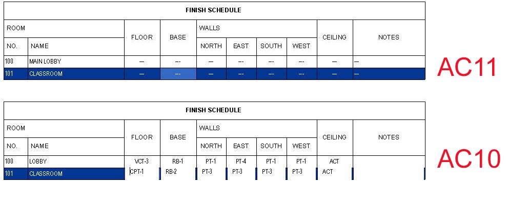

Our Door Schedule and Window Schedule IS's from AC10 work fine in AC11, but I cannot get our Area Schedule and Finish Schedule to cooperate! I ran into similar problems when migrating from AC9 to AC10, but they were remedied by recreating the IS.
Now, I can't get anything to work. I've recreated the IS's, I've tried taking the "Additional Parameters" from the extracted library instead of the LCF, I've tried taking one of the working IS's and editing -- nothing. These are just (custom) listing parameters! All the values remain blank (---) and locked! Why is this happening, and why are our other two schedules working just fine?
Any thoughts?

Working from memory, I had something similar to this, and it turned out to be the layers,floor, and view options that were automatically attached to the schedule's View when it was dragged from the Project Map to the View Map.
Deleting the schedule from the View Map and recreating the view while everything was unlocked and displayed fixed the problem, if I recall correctly.
This is similar to how I corrected the problem when migrating from AC9 to AC10, but it had no effect in AC11.

Well, this effect is pretty much what you get when the parameter being called is just not there in the zone stamp. Is it possible that the AC11 zone stamp that you're using has changed the names of the parameters slightly? In any event, would look at the IS setting for the name of the parameter being called in the schedule, and make sure the zone stamp actually has those exact parameter names.
It is the same (identical) Zone Object. I sent the files to GS Tech Support 3 months ago, but haven't heard back.

Concerning my issue: I have heard from GS (via Karl Ottenstein) that this is indeed a bug, and they are looking to resolve the problem.
