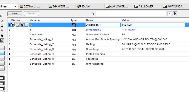

Dave Seabury
Tom
With the shape tag you can add Parameters for what ever values
you want to schedule, see attached
David
AC 19-26 Windows 10 64 bit, Dell Prercision 7820, Xeon Silver 2414R ( 12 Cores), 64 GB Ram, Quadro RTX 4000 8GB
Tom Krowka
That will work. Not quite the way I envisioned, but close enough. Thanks.
