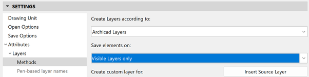

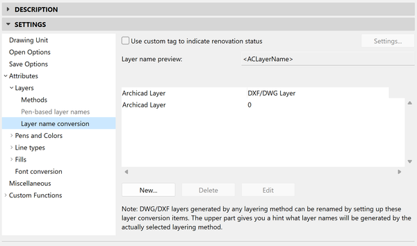

In my translator, under 'layer name preview' it says '<ACLayerName>', which suggests I should get exactly what I want - just the original AC layer name...
And, under 'Methods', layers are set according to 'Archicad Layers'...
... However in the exported DWG, all the layer names are separated and prefixed by the view name
Is this normal? Is there a solution for what I want?
