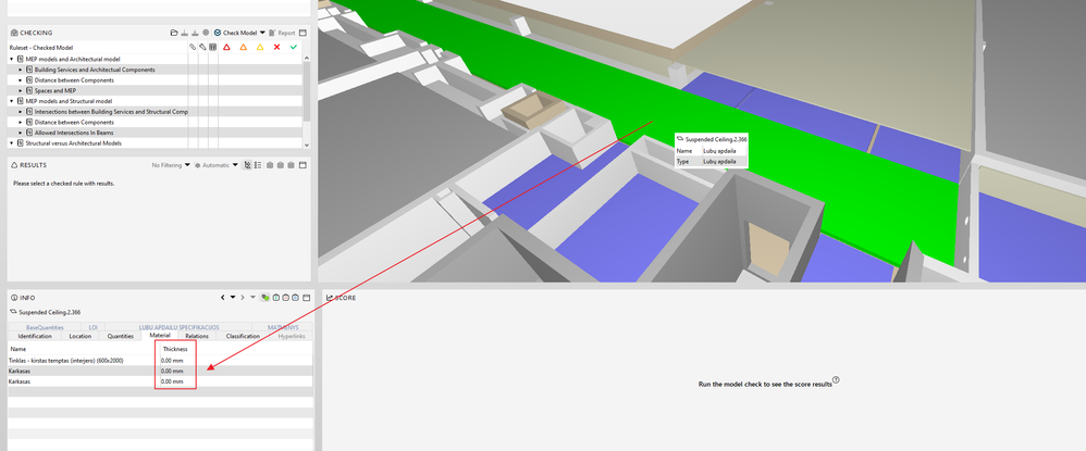

I have a problem exporting material thickness to ifc. The filter is okay - other models are exporting correctly with it, but one of the models export materials without any thickness (I can see materials, but their thickness is 0). Can't find what's wrong. Do you have any ideas how to export them? or any clue what's wrong with the model?
I also get this error when exporting (you can see it in attached file)

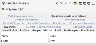

I'll add a bit to Ieva's inquiry: checkbox is checked in all materials, so I guess this should not be a problem. The problem seems to be with IfcCovering (Ceiling, Cladding, Flooring) - it exports the Material tab, but the thickness is still 0mm, where IfcWall is exported normally. I'm adding a couple of printscreens below.
Thank you in advance!
OK, I see, so the geometry is actually correctly exported to IFC (the element has thickness), but the thickness Properties report 0 mm for thickness for some reason.
I would say that this is a bug so I will report this to Graphisoft for investigation.

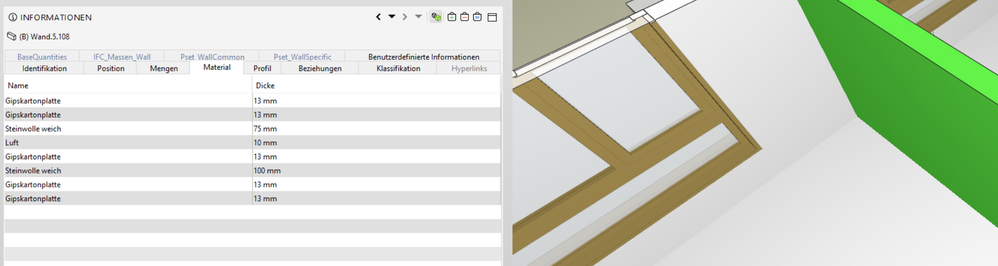

Thank you very much for sharing this problem! We have consulted it with our developers and it turned out to be a limitation of the IFC Schema and Solibri:
The parametric composite structure can only be preserved in IFC for IfcWall and IfcSlab via IfcMaterialLayerSetUsage. Solibri shows the thickness value from that, if it's present, otherwise it shows 0.
So this is a bug of Solibri (showing 0) and a limitation of the IFC schema (disallowing this structure for other types).

Thanks for your provided explanation - this behaviour is still valid till the present day for models generated by AC. Interestingly is that in the provied screenshot above the walls indeed have thickness and it solely seems to be a covering issue whilst I get this problem all the time ...
However, if this is a IFC limitation, why is it then working correctly for some models - even those exported from Revit?

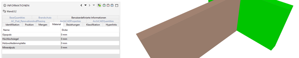

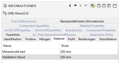

More confusion arises as I have received a model today generated by (Archicad 26.0.0 AUT FULL Windows version (IFC add-on version: 4022 AUT FULL) which is indeed showing for some elements the correct thickness in Solibri ....
When I tried to recreate this with the same version on my side I failed ....
Tried all kind of setting combinations but did not succed.
Then I realized that also in the file I received this is not working for all elements as some indeed have a zero thickness.

Ok, I realized that Solibri seems only to show the thickness correctly if the Geometry Conversion in Archicad is set to Extrusion -> so BREP does not work with Solibri, can you confirm/elaborate if this is a technical limitation or if there are any other ways to get this to work with BREPs?
