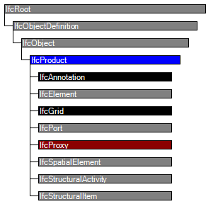

The IFC Entities you can address from Archicad don't allow the full IFC scheme. You get the IfcRoot > ... > IfcProduct > IfcElement and IfcSpatialElement branches, but not the IfcPort branch.
ifcproduct
