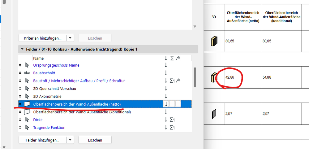

I can choose Net Areas in Archicad such as:
Which shows net area (without any windows etc) of 42.86m2.

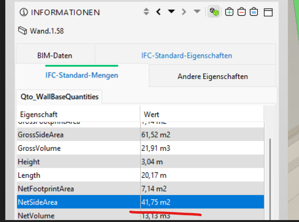

If we add the a balcony next to a wall, NetSide Area decreases from  42.86m2 to 41,75 m2. Which is visible in ifc viewers such as solibri and other ifc softwares, such as Orca etc:
Where could I find this NetSideArea in Archicad scheme settings?

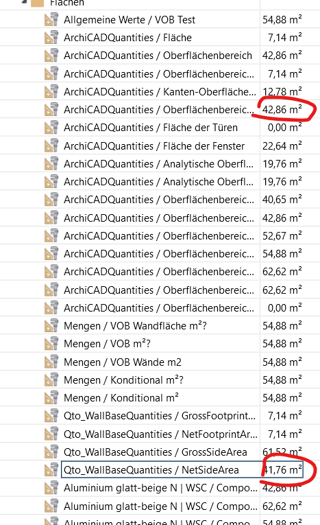

If that helps, here we can see a printscrean from ifc software Orca:
We see that Neto areas from Archicad are shown as: Archicad Quantities of 42,86m2.
I would like to find a property in Archicad, that is in other ifc softwares seen as Net Side Area, which we can see above as: Qto_WallBaseQuantities / NetSide Area of 41,76m2
Anyone knows where could I find it in Archicad?
