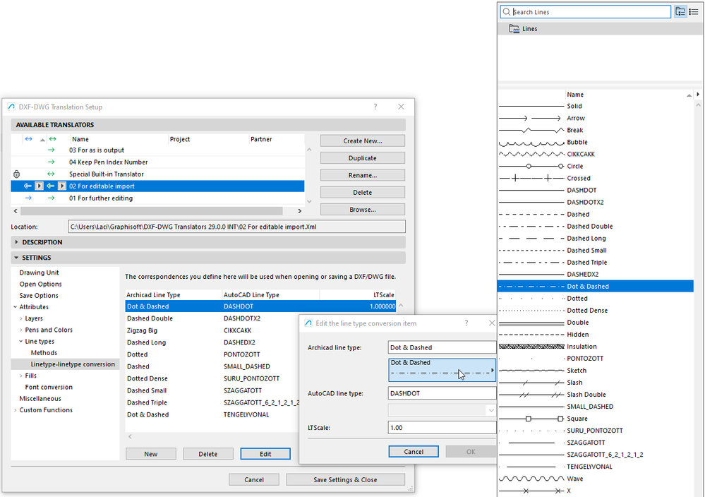

I think you misunderstand something.
There is no such thing as creating a Line Type-to-Line Type conversion where you do not specify the Archicad Line Type.
You always specify an Archicad Line Type to which the specified DWG Line Type will be converted.
The DWG import will create a Line Type in Archicad only if the DWG file contains a Line Type for which there is no Line Type-Line Type Conversion rule specified in the DWG Translator used for the import. So, the DWG import takes all line types found in the DWG, then checks which ones have a conversion rule, and will generate Archicad line types only the rest.
What we know for sure is that the "Archicad Layer" Layer in Archicad, and the "0" Layer in AutoCAD/DWG are special layers that always exist and cannot be deleted.
I tested this and it seems to me that no Layer Name Conversion rule works on the DWG "0" Layer on DWG Import; it is always converted to the "Archicad Layer" Layer. What confirmed this to me is that:
1. I create a Layer Name Conversion rule to convert the "0" DWG Layer to "000000" in Archicad.
2. When I start importing the DWG, a Layer Dialog appears that lets me select which DWG Layers I want to import. The "0" Layer is the first on the list.
3. When the DWG Import is finished, I check the Layers and there is no "000000" Layer created (so the Layer Name Conversion did not work on the "0" DWG Layer), but at the same time, there is no "0" Layer either, and what was on the "0" Layer in the DWG file is now on the "Archicad Layer" Layer in Archicad.
I tried this with DWG Export as well: the "Archicad Layer" Layer does not convert to anything, and in the generated DWG file, what was on the "Archicad Layer" Layer in Archicad is now on the "0" Layer.
So, I think it is safe to say that the "Archicad Layer" Layer and the "0" Layer always convert to each other back and forth and Layer Name Conversion rules have no effect on them.
I will talk to the guys at GS HQ who wrote the Help file so it can be amended with this information (after verification, of course).
