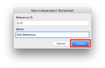

1. Create a worksheet dedicated to the consultant DWG.

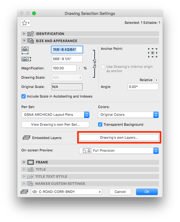

1. Select the drawing and open its settings.

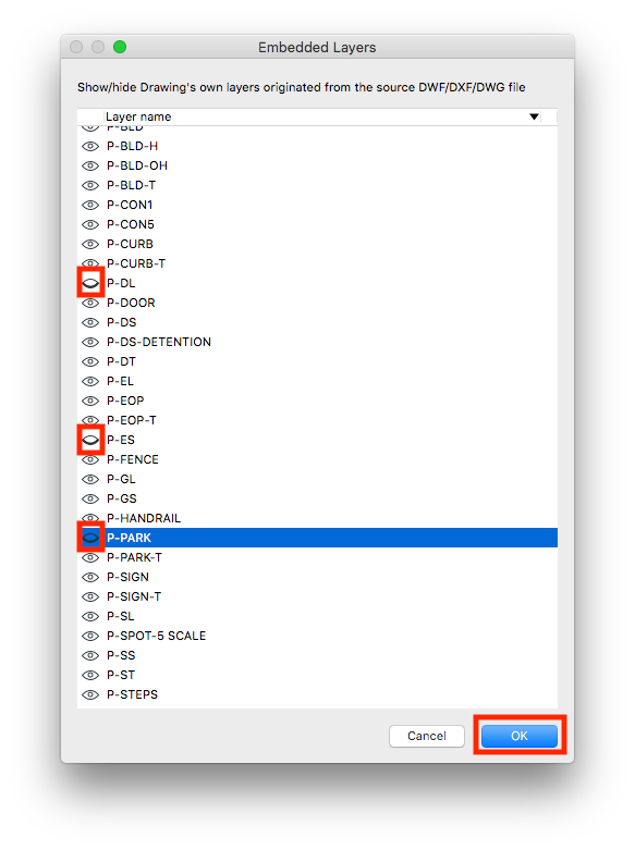

2. Under the Size and Appearance tab, click the Drawing's own Layers button.
3. In the Embedded Layers dialogue box, turn off unneeded layers and click OK.
4. Click OK to finalize the changes.

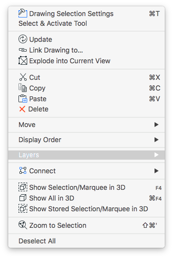

1. Right clicking on an element in the placed DWG and select Layers > Hide Embedded Layer

1. Select the placed DWG.
2. Right click and select Link Drawing to...
3. Select the updated version of the DWG and click Open.
