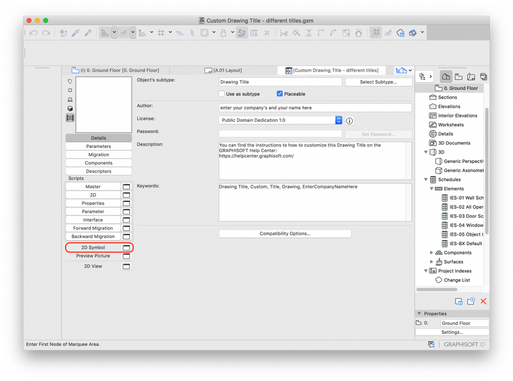

  3. The Drawing Title Object should open in the GDL Object Editor View, with the ’Details’ tab selected from the left-hand menu. Fill these fields (Author, Description, Keywords) as you see fit.
  4. Click the window button next to ā€ž2D Symbolā€ in the left-hand menu to open the 2D Symbol Editor Tab/Window.

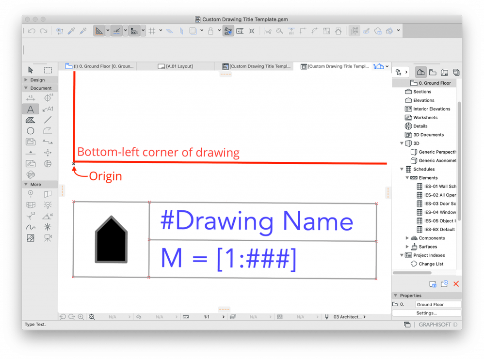

  6. The origin represents the insertion point. Make up your mind which corner you want to place the final title on, and place the title around the origin accordingly. You can see an example below with a bottom-left corner placement.

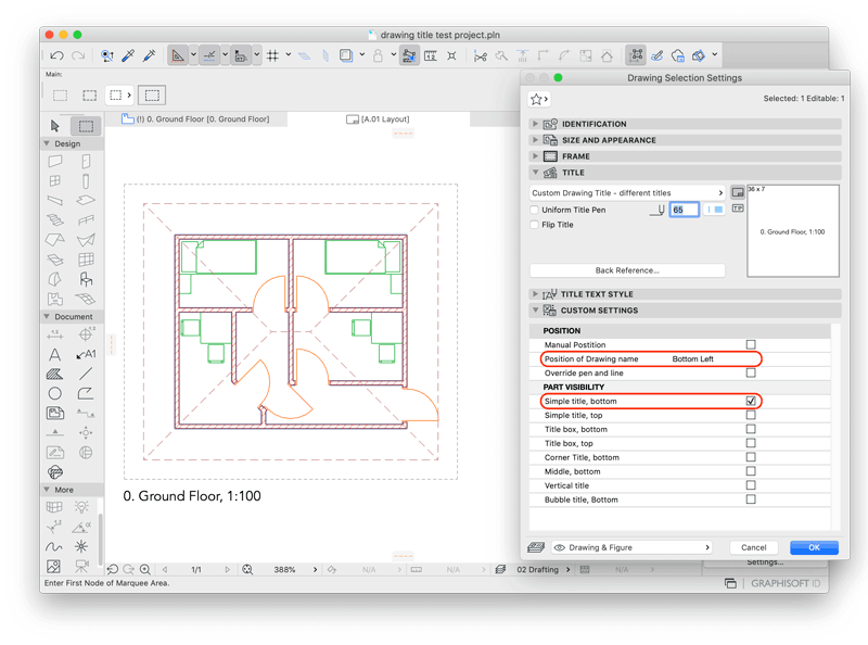

  10. To use the Drawing title, open the selection settings of a Drawing, go to the "Title" tab, and choose your newly created Drawing Title from the drop-down list.

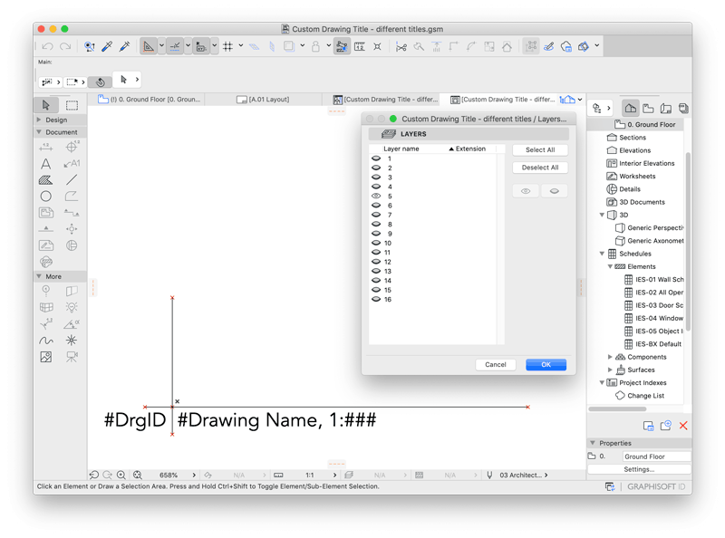

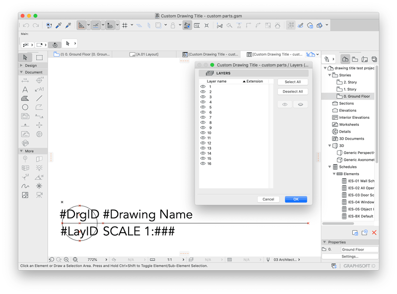

  4. The 2D symbol window has 16 layers (use cmd+L/ctrl+L to open the Layer Settings Dialog). You can place different drawing elements on different layers (just like in a floor plan view) and later change their visibility from the finished drawing title. There are 2 ways to go about this step:
    • You can place each part of your drawing Title on different layers, so you can later turn them off separately (Drawing ID on Layer 1, Layout ID on Layer 2, etc.):
    • Alternatively, you can design different drawing title styles and place each of them on different layers (Drawing Title #1 on Layer 1, Drawing Title #2 on Layer 2, etc.):

  5. Once you set up all your drawing elements on the different layers, close the 2D Symbol tab and go to the Parameters tab in the left-hand side menu in the GDL Object Editor Window.

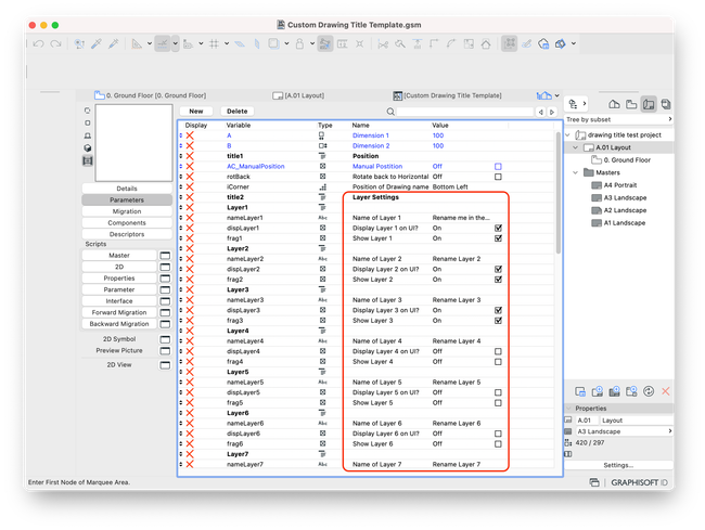

  6. Amongst these parameters, you will find parameters grouped in threes. Each group is for a single layer from the 2D Symbol. The first item in each group will let you change the name of the Layers (this will appear on the User Interface). Enter the name you would like to see into the field on the right side, where it says "Rename...".
  7. The second setting in each group will let you control whether the settings of this Layer should appear on the User Interface. Tick this box ("On"), if you placed content on this layer, and you would like to be able to control its visibility and color in the future. Leave it unticked ("Off") for Layers that are empty.
  8. The third option in each group will let you pick whether the Layer should be turned on in the default settings of the object. Tick this box ("On") for those Layers that are that should be on by default.

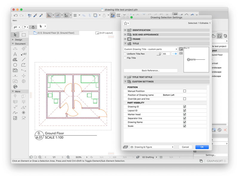

  10. To use the Drawing title, Open the selection settings of a Drawing, go to the "Title" tab, and choose your newly created Drawing Title from the drop-down list.
  11. If you go to the "Custom Settings" tab, you can change the title type and position to suit your needs.
    • Here's an example of the results with optional contents:
    • And here's an example of the results with different drawing titles, for different positions:

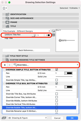

  • You can use the ā€žUniform Title Penā€ and ā€žFlip Titleā€ options from the Title tab of the Drawing Settings to override the saved representation.
  • On the second page of the Custom Drawing Title Settings you can turn on an Attribute override for each of the Layers Separately, and set a custom Pen and Line Type for each.
