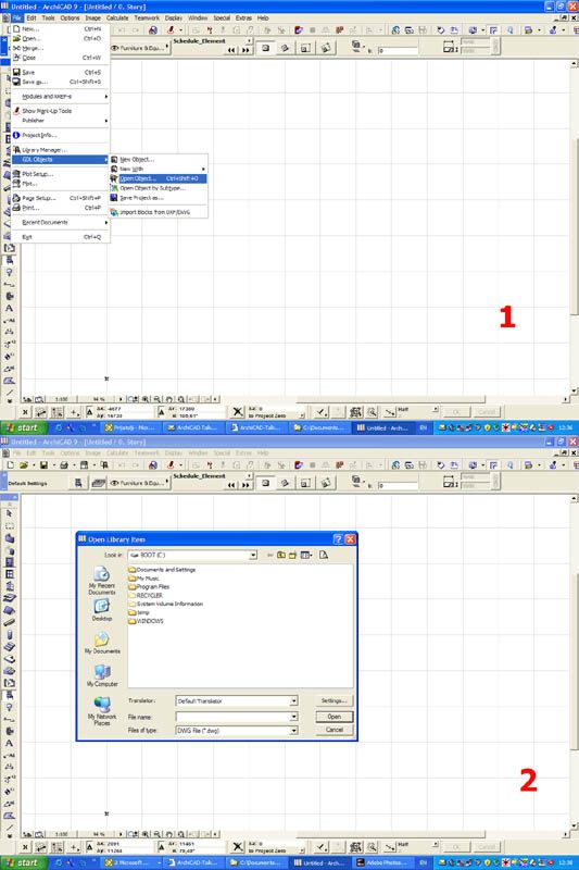

You import the 3D DWG/DXF/3DS as a library part. If you have to manage portions of it, first break it down in required pieces outside ArchiCAD. Another use for Maxon Form maybe?
If plain vanilla ArchiCAD, go to File/GDL Object/Open Object. In the file type, select DWG or DXF. Make sure that in the Settings button the correct translator is set (units are essential). See attached.
For 3DS, use the 3DS in that you can find in your Goodies folder.
HTH,
