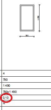

I am starting to be a bit frustrated... Does anybody know how to change units in window schedule (sill value) to use [mm] instead of ?
I have mm on plans - that's ok. Windows' settings looks correct as well. I have tried in project preferences > dimensions, but it's also correct. I have no idea how to switch this annoying meters... Thanks in advance for any hint.

What you are doing is right. Nevertheless you have to take in account that if the Schedule is saved as a View in the View Map, those Dimension units may be saved in meters. If that is the case just change the settings of the View.
Remember to check under Preferences / Dimensions, all the options : linear dimensions, sill heights dimensions, and window and door dimensions.
Check Calculation Units too, those will calculate some of the dimensions for objects, like in your case, the sill height.

Indeed! Of course that was last thing I've checked (according to Murphy's law) - calculation units . End of frustration Thanks a lot!
