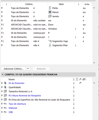

When you define the criteria for the Curtain Wall Schedule, you should use the "Element Type is Panel" criteria, which should schedule Curtain Wall Panels, including Curtain Wall Doors and Windows.

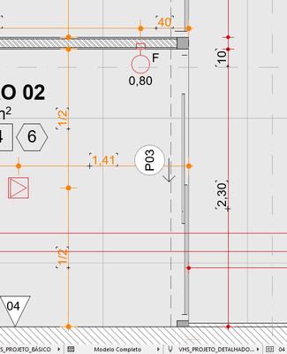

Agreed to all above. I'd like to add that being able to assign window/door markers to curtainwall panels classified as doors or windows is a necessity. I can't make a curtainwall door show as any other door with a marker on my drawings with a zone name + ID. The tool itself is great, but let's get some usable data out of it!

@SGraham_MGArchitects you can press tab to select only the panel in the curtain wall when holding the door label tool. It will grab the ID.
And you can set the panel to a door classification, so you can filter it in the schedule, but it will not show the dimensions.

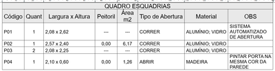

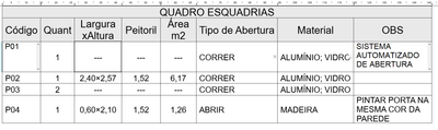

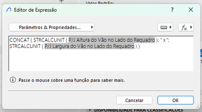

I managed to create a property that collects the size of windows/doors or the size of the panel:
You can do this to each information you whant to show, a property for each information.
