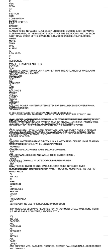

Does anyone have any solutions/recommendations for archicad exporting to DWG and large text box formatting issues? So far, all I've been able to do is copy/paste them into word or save a pdf and ask consultants to import or retype on their end (not ideal on either side of the exchange).

Same text in AutoCAD:

DXF-DWG text formatting is known to have problems unfortunately, but I wonder how exactly did you create these columns?
There is no direct column formatting support in Archicad Text elements like in Word for example.
If you attached a sample file it would be easier to understand your issue.

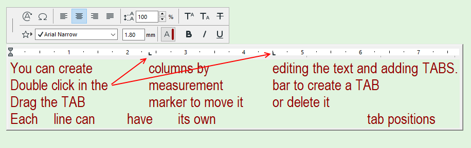

You can create TAB positions in the text editor.
