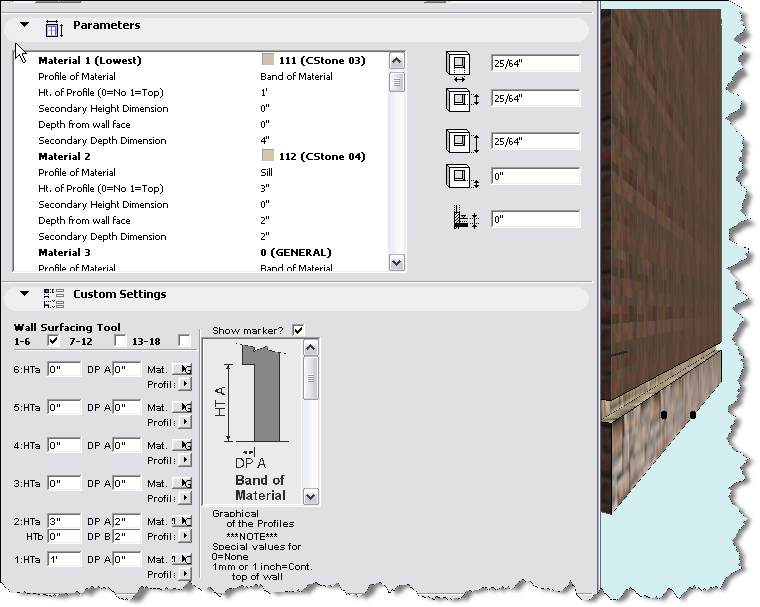

I have tried unsuccessfully to get an answer from the author of Wall surfacer. I cannot get it to create a sill instead of a reveal.. I hope someone here that uses it may be of help. I have tried every combination of settings but no luck. If you have one done please reply with a graphic of the settings so you don't have to give an elaborate description..

Since wall surfacer is only cable of cutting out of the wall. the wall thickness must equal the thickness measured at the sill. Then the upper and lower portions must be set inward by the dimension depth that you want the sill to project.

So I have to make thicker walls for each situation depending on how deep I want my sill to be? I think it complicated the model just for a 2" sill. I just may stick to profiler when the sill will not have any openings in it.
