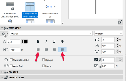

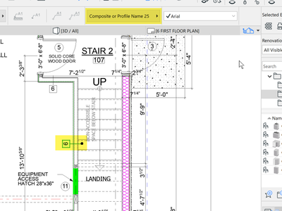

What could be done to configure the Wall Tag Label so the ID is in the right place when the file is saved as .dwg ?
It's a pain to edit all of them in AutoCAD.

The solution is this -
Either one of these text alignment settings work - the two in the middle don't. I had them all set to Center the text in the Lable but that does not work - at least when opening the generated .dwg with AutoCAD 22. Problem is solved for me.

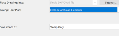

Hi, you need to make sure that your dwg translatior, doesn't have this option checked.

Not making any differnce with the Wall Tag Label I am using
What does help some in speeding up the editing is to use the setting for Explode Archicad Elements. But that is not a good a good solution either.
2022-06-22 08:33 PM - edited 2022-06-22 08:36 PM
